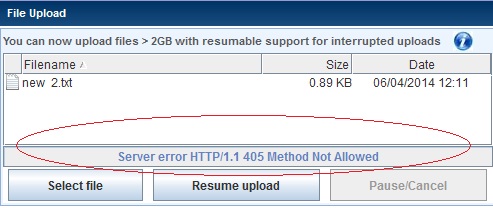

But we getting a "Server error HTTP/1.1 405 Method Not Allowed" inside the applet after upload and upload fails also.

we think the handlers is not working and that is the cause of the error.
Please suggest us proper handlers to include to make it working in Integrated Mode of app Pool .

It looks the upload request is not accepted by the server. JFileUpload uses HEAD/POST (multipart) or PUT depending on how you configured it.
